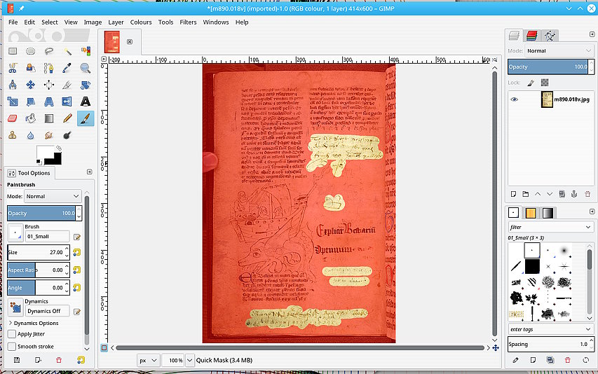

1. Select the areas required. I used quick mask but freeselect in add mode works as well. see screenshot 1

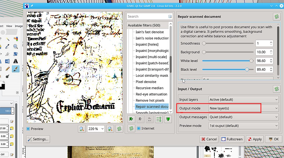

2. With the selection active (toggle quickmask off) use the gmic plugin www.gmic.eu and the repair scanned documents filter. Output typical settings and output mode shown screenshot 2

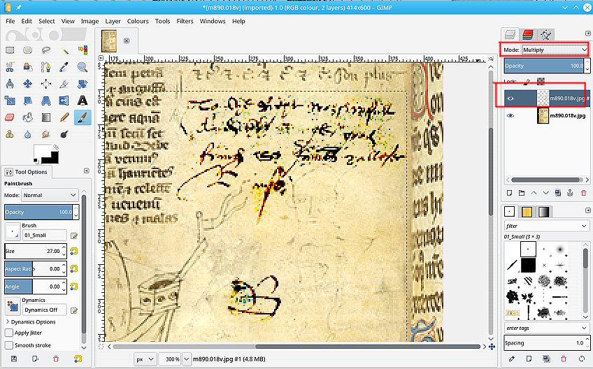

3. Gives this with when selection is turned off screenshot 3

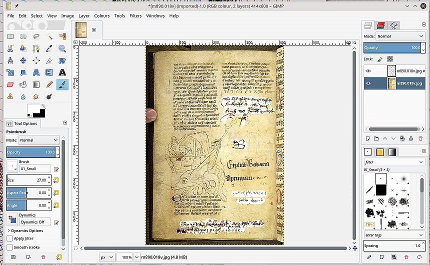

4. Put the new layer into Multiply mode to merge, gives as screenshot 4 but back to small image size and pixel sized graphics.
