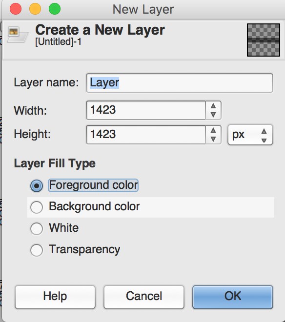

Thanks, Rich. Ok, I got to step 5 about creating the new layer, but I'm having trouble with the step "(have Foreground set to Red when you do this)". My new layer dialog doesn't look like the one in the tutorial (attached). I can't see where I select a color in that dialog.
Btw, my bad on the version. Its 2.8.18.
Check the screenshots
Click in the Foreground (FG) colour icon (1) that brings up the Change FG Colour dialogue. You do not really need the colour picker in the dialogue, click on a colour or use the sliders.
To use the colour picker. Click on the picker icon (2) and you can pick from anywhere in the dialogue or in the image (3).
Until you get the hang of things, OK to close the dialogue and fix the colour.
You can get a new layer easily using the icon in the layers dialogue (4) Brings up the dialogue as you posted, or use the Layer menu. With FG set that uses the new colour. I prefer a transparent layer and fill it later, up to you.
Move down using the icon (5) in the layers dialogue or use the Layer -> Stack menu
An easy way to fill a layer with colour is click-n-drag from the FG (or BG) icon into the canvas. (6)
