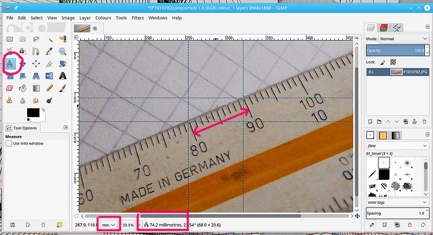

You need to adjust the Image -> Print Size resolution values to match the captured ruler scale.
First set the canvas units to whatever you are using - cms The example I used is millimetres. That is the drop down units menu (7) shown here: https://docs.gimp.org/en/gimp-image-window.html
Then use the Gimp measure tool to show the on canvas size. screenshot 1 measures 10 mm as 74.2 mm Use some guides if they help, the measure tool can snap to intersections.
Then it is a matter of simple proportions to get a scaling factor in my case 74.2 / 10 = 7.42

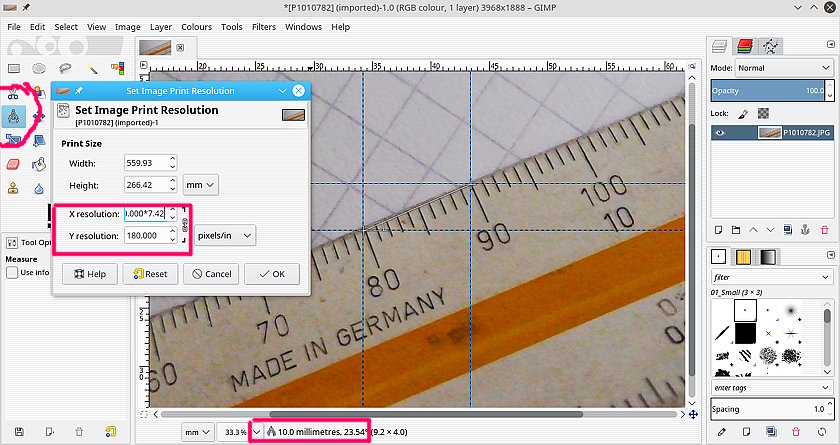

Open up Image -> Print Size and multiply whatever resolution is there (mine is 180 ppi - comes from the photo) by the scaling factor. Do by hand or Gimp can do simple arithmetic * multiplies / divides.
With that changed the measure tool should now show dimensions corresponding to the image. screenshot 2
