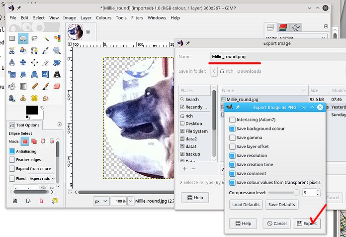

An image will always be rectangular but certain formats will permit transparency. Jpeg is **not** one of those.
Very little change to your procedures.
Open Image, Add an Alpha Channel for transparency, Layers menu -> Transparency -> Add Alpha Channel.
Make your Elliptical selection, Invert it, Cut it. The transparent bits are depicted as a checker pattern. Kill the selection. Selection -> None
Now the important bit. Export your image as a png. File -> Export As Give the file a name **including** the .png suffix. Just keep the default settings.

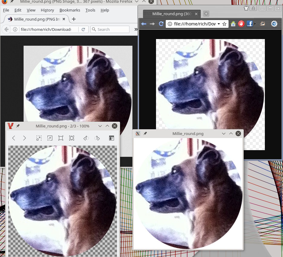

Thank you Rich, but I did use those exact steps. The issue is that even though the "square" is transparent, it is still there. When I then open the rounded .png file in Meshcam (the software I am using for the next step in my process) it is displayed with the square again.
It is the application displaying the png that is to blame. Some will 'honour' the transparency mask, others not.
example screenshot: left to right
Top -Browsers: Firefox **not** - Slimjet browser does
Bottom - viewers: viewer1 does - viewer2 **not**.
That does not mean that the end result will not be ok. In your case, you will only really know when you etch something.
