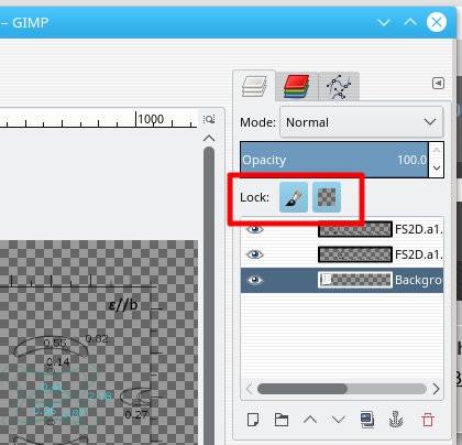

First an explanation as to why you will run into problems trying to adjust your 3 layers.
The background layer has both alpha (transparency) and pixels locked. You might have done this to fix the layer location. That is not their purpose. Easy to click on the icons and unlock. see attachment

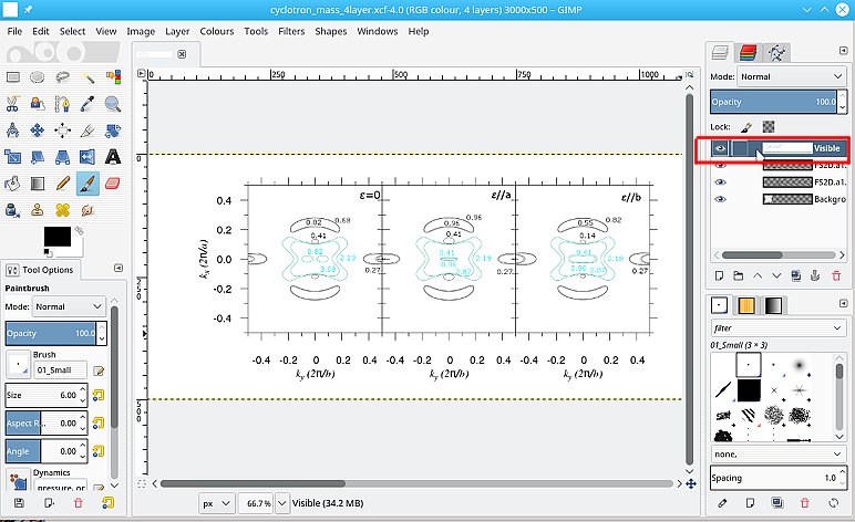

Then you could apply Colors -> Color-to-Alpha to remove the white and put a new white layer at the very bottom of the stack.
However the quickest way.
With the top layer active Layer -> New Layer from visible to combine the 3 layers.
With the background colour white. Layer -> Transparency -> Remove Alpha Channel see attachment.

The second way
(1) (2) Yes, Losing the alpha-channel on the new-from-visible does hide the layers under it. The main reason for using it is non-destructive. The original layers will be there in case later editing is required. Remember to save your work in xcf format. All layers, masks, guides, text layers .... are saved.
The new-from-visible layer can be hidden by toggling layer visibility - the little eye icon.
(3) Removing the alpha channel will replace transparent pixels with the background colour, not necessarily white.
Lock pixels/alpha icons state can be a little difficult to see when using Windows. That screenshot I put up is in linux. Look for a border after clicking the icon - see attachment
