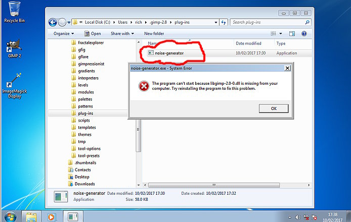

***Do not try and run a Gimp plug-in from outside Gimp***. see attachment 1 - no need for additional dll's

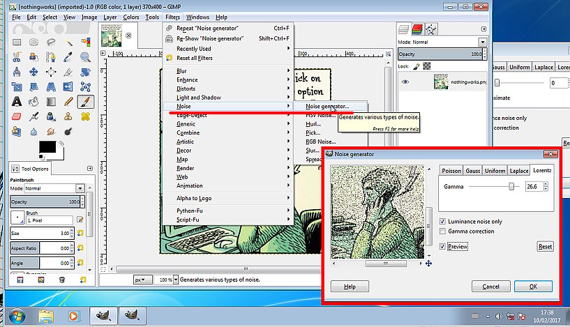

The plugin will be in the menu system, in this case see attachment 2.
Any valid script or plugin can be located in the menu system using Help -> Plugin Browser.

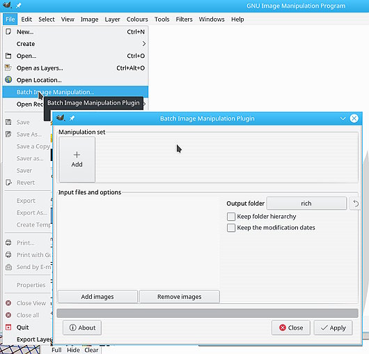

BIMP for Windows in this case is an installer, the file gimp-plugin-bimp_win32.exe
After installation, do not run bimp.exe, use the Gimp menu entry File -> Batch Image Manipulation... see attachment 3
