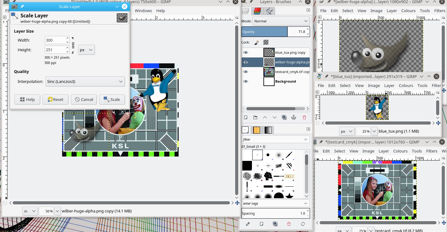

Might look like attachment 1 where everything is wrong size, wrong place.
For each layer use Layer -> Scale layer and resize to suit. Then use the move tool to position.

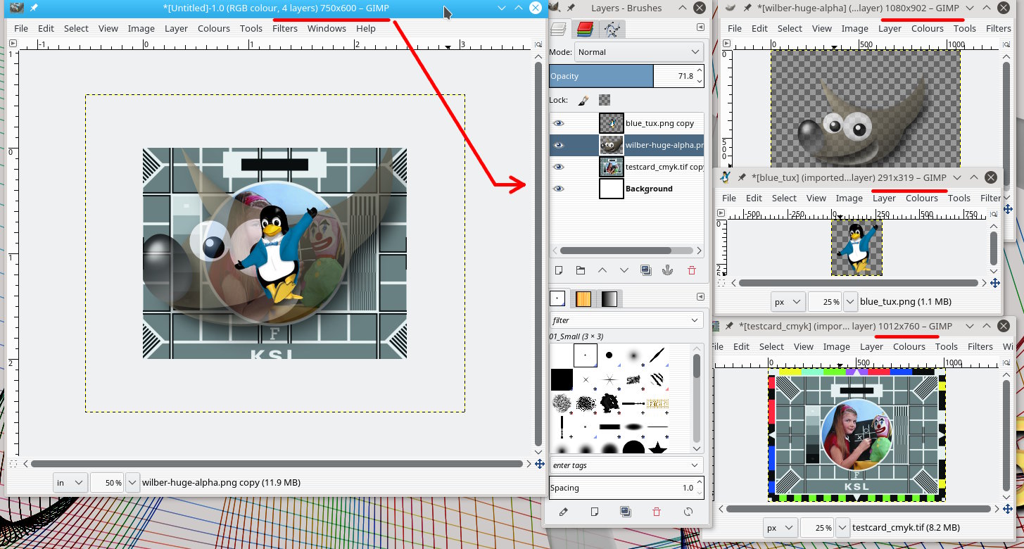

Might look like attachment 2 The yellow dotted line is a layer boundary.
Now you can go into Image -> Print Size and if required set the print size to 2.5" x 2" and the resolution should follow suit to 300 dpi.
