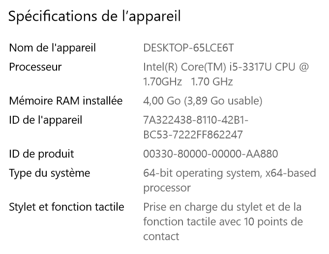

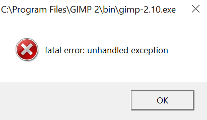

Can someone help me, I have install GIMP 2.10 for windows x64 but when I want to launch it, I have an error "fatal error :unhandled exception" (see attached), the configuration of my surface pro is in the attachments. Thank you very much, I have reinstall it 3 times but nothing

The same error here - restarted, reinstalled, uninstalled... 2.10 still crashes instantly. 2.8 never did.

Please check the file name of the installer you used - if it is not gimp-2.10.0-setup-2.exe, then you got an older version and should get the current download from https://www.gimp.org/downloads/

I use GIMP on a Windows PC and I had the same problem. I finally discovered that it was an incompatible plug-in. I had installed Gap for gimp in my previous version. I believe that the plug-in is not compatible with the new processing engine. (just a guess) A simple uninstall through the control panel did not work. When I reinstalled GIMP, it still had the same error. When Windows uninstalls GIMP it leaves behind some files and folders that contain your plug-ins, themes, etc. I had to go and delete all of those folders and then reinstall GIMP for it to work. Here are the folders that you should delete.
C:\Program Files\GIMP 2 C:\Users\\AppData\Local\GIMP
The AppData folder is hidden so you may need to turn on the show hidden files and folders option in the folder options link in the control panel to see it.
This will also delete all of your themes and brushes. If you have any custom themes or brushes, you should back them up before you delete the folders. They can be found: C:\Program Files\GIMP 2\share\gimp\2.0\themes and C:\Program Files\GIMP 2\share\gimp\2.0\brushes
After I deleted all of those files and installed GIMP again, everything worked just fine.
Hope this helps.
