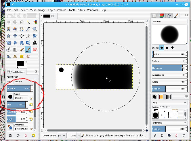

I can't change brush size in GIMP. I've been working on this simple task all morning. I've downloaded and installed the most recent stable version of GIMP (2.8.22). I've created a new brush so that I can edit it. Changing the radius of the brush does nothing (see attached image). I'm about to throw my computer out the window. Please, help, help, help!

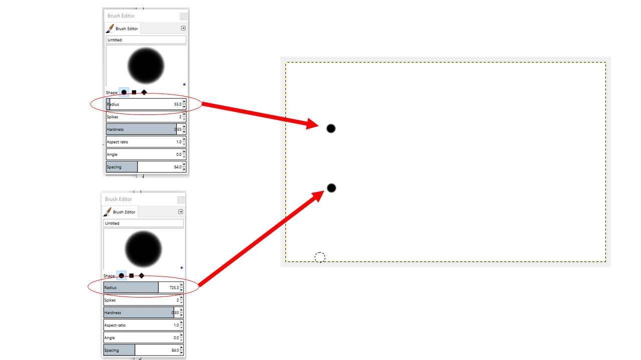

That is not the way it works.
The brush designer does what it says, designs a parametric (.vbr) brush, which is a bit like a vector, the brush is a text file description of properties.

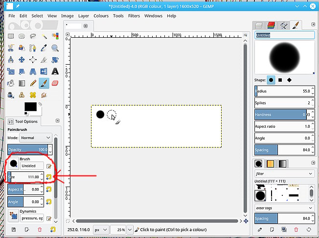

Each brush has a 'natural' size, which you can reset in Gimp 2.8.22 using the little yellow arrow in the Brush tool options. see: small-brush
Exactly the same brush can use the size slider to resize to the new size ( 2x the radius) so for a 725 radius use 1450. see: large-brush
You could save both of your brushes radius = 55 and radius = 725 as separate .vbr files and use the little yellow arrow to set the size, but it is a bit pointless when one will do.
http://www.gimpusers.com/system/attachments/572/original/brush_size.jpg
Change the size in the paint tool options.
